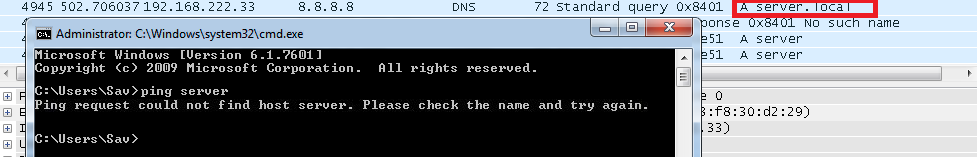

The option can be seen in network packet dumps when receiving an IP address from a DHCP server.
The result of this option is also visible in DNS query dumps when attempting to access a resource by name without a domain.

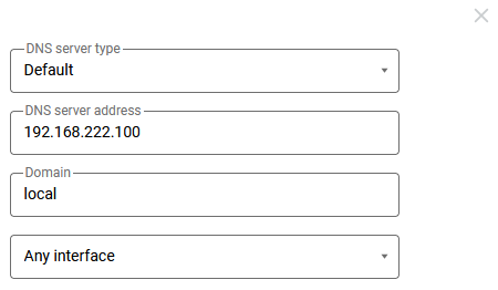

2. You also need to register the local DNS server for the local domain on the router's Internet Safety page on the DNS Configuration tab; otherwise, requests will go to the provider's DNS servers.

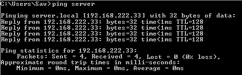

Now, from the host that received an IP address from the Keenetic DHCP server, you can access the server named server.
