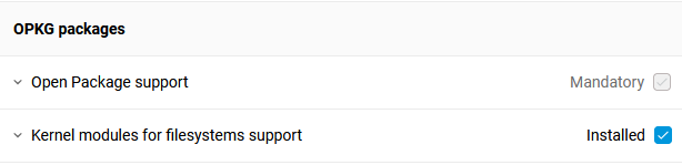

Starting from KeeneticOS 3.7 version, for some of the Keenetic models, it is possible to write OPKG Entware to the UBIFS partition of the router's NAND flash memory, i.e. to the built-in memory of the router.
To support this feature, you will need to install the following components:

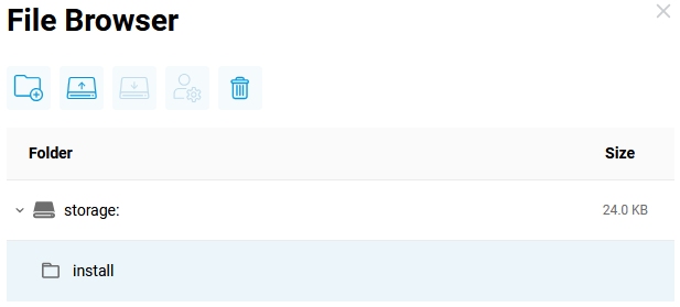

On the Applications page under USB Devices, click on Internal storage and then on the built-in storage partition create the install folder:

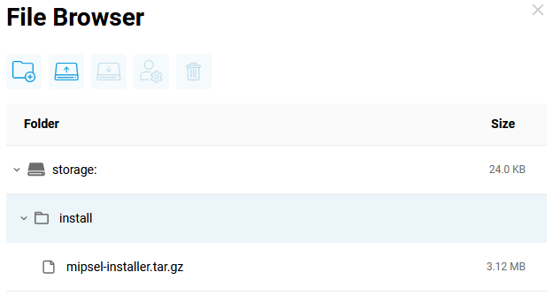

In this folder you need to upload a special archive file, depending on the device:
Note
For Ultra (KN-1811) model, use the aarch64 archive — aarch64-installer.tar.gz
In our example, we will consider installing the mipsel archive.
