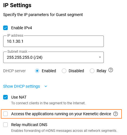

level but without access to the router.The
protected
type is set for the Wi-Fi guest network interface when the 'Enable access to home network applications' option is disabled in the web interface on the 'Guest segment' page in the 'Restrictions for devices in the segment' section. By default, access to Keenetic is prohibited from the guest network. If you allow access to settings, this interface will be set to theprivate
