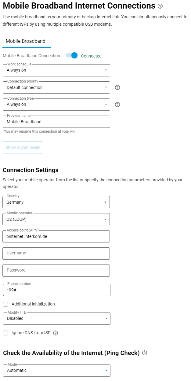

RAS (Remote Access Service) mode is a modem mode. When a modem is connected to a router, the UsbModem interface is automatically created in the settings. This type of modem requires manual configuration of the connection settings. In the Mobile provider field, you must manually select the operator providing Internet access for your USB modem. Other settings of connection to different mobile Internet operators' networks are already preset in the Keenetic operating system and usually do not need to be changed.

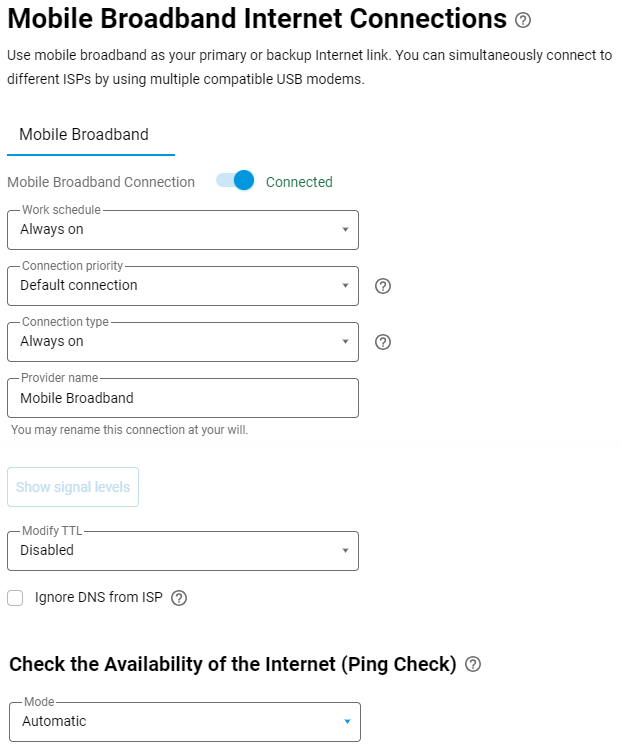

You can configure the modem in the web interface on the Mobile Broadband Internet Connection page.

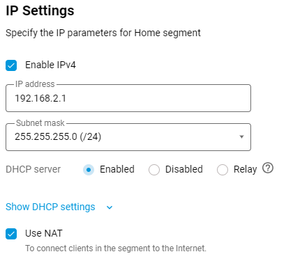

There are modems in CDC Ethernet mode that give an IP address from 192.168.1.0/24 subnet that matches the IP address of the Keenetic router's home network (the default IP address of the router is 192.168.1.1). KeeneticOS has an IP conflict prevention function on WAN and LAN interfaces. It is enabled by default for CDC Ethernet USB modems. When such a modem is connected, Keenetic will detect an IP address conflict, automatically change its home network IP address to 192.168.2.0/24 and reboot. To avoid guessing what IP address is on your Keenetic router (192.168.1.1 by default or changed to 192.168.2.1 after this USB modem was connected), it is better to open the router's web interface by entering in your web browser the pre-installed name my.keenetic.net instead of the IP address. You can check if the IP address has changed in the web interface on the My Networks and Wi-Fi page under IP Settings.

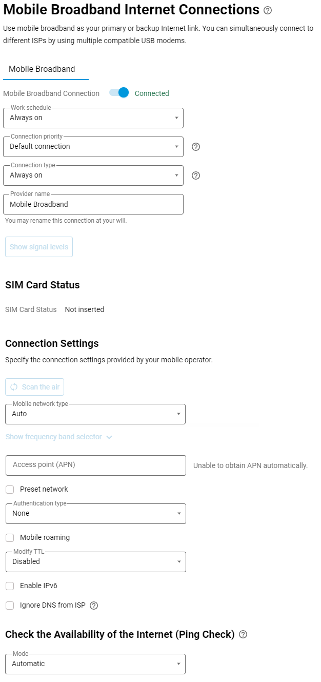

NDIS mode emulates a virtual network interface controller. These modems appear to Keenetic as an additional network adapter. When the modem is connected to the router, the UsbLte interface is automatically created in the settings. Usually, such modems, once connected to the router, will work automatically, without any additional settings in the web interface. If necessary, additional modem configuration can be done on the page Mobile Broadband Internet Connection.

When you connect the modem to the router, the UsbQmi interface is automatically created in the settings. You can configure the modem further on the Mobile Broadband Internet Connection page.
