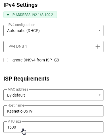

In the web interface, this setting is available on the Ethernet Cable Connections to Internet page in the IPv4 Settings section and the ISP Authentication (PPPoE / PPTP / L2TP) section if you are using a connection via the respective protocol.
In the IPv4 Settings section, in the MTU size field, you can specify the desired value between 64 and 1500. For a wired IPoE connection, the recommended MTU size is 1500.

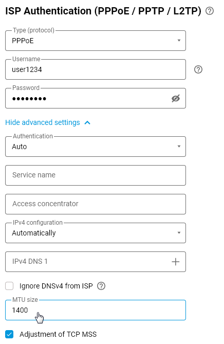

In the section ISP authentication (PPPoE / PPTP / L2TP) click Show advanced settings. In the MTU size field, you can specify the desired value in the range from 64 to 1500. Ask your ISP for the recommended MTU value.
