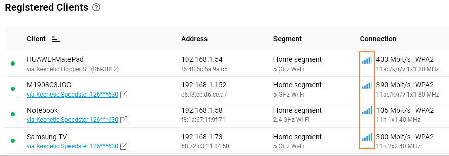

In the Keenetic web interface, the Client Lists page shows the signal strength indicator of the connected client as a relative value in the form of a graphical 'staircase' scale. The scale is displayed according to the received signal strength measured at the receiver. The RSSI (Received Signal Strength Indication) parameter in dBm is used for this purpose. The RSSI value can be found using a special command. For more information, see the article How to get information about Wi-Fi clients?
The correlation between the bars of the graphic scale and the RSSI level is as follows:
5 bars — RSSI above -50
4 bars — RSSI from -51 to -77
3 bars — RSSI from -78 to -84
2 bars — RSSI from -85 to -97
1 bar — RSSI from -98 to -110
0 bars — RSSI below -111
