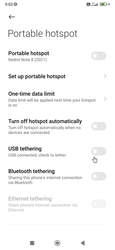

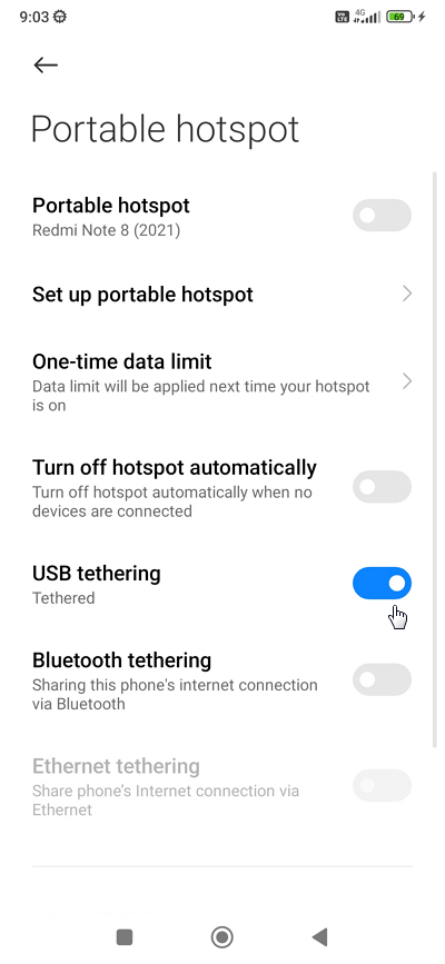

Connect your phone to the router's USB port with a USB cable. Switch on the mobile Internet on your phone (in the OS settings, this option is called Data, Data transfer or Mobile data transfer). Then activate USB tethering mode.
On different versions of the Android operating system, the process may vary.

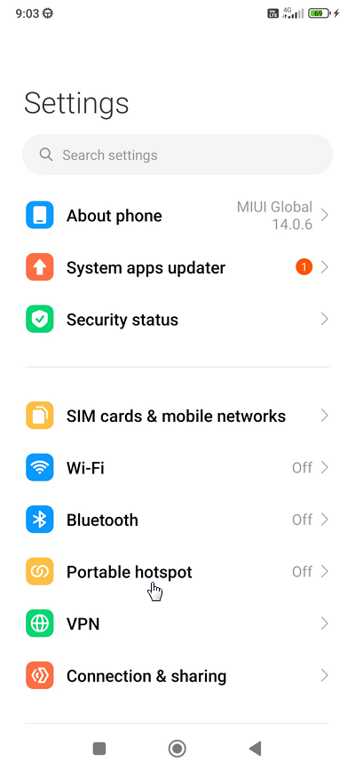

In our example, we are using a device with Android 13. In this version, open Settings, click on Portable hotspot and activate USB tethering mode.
This completes the phone setup.

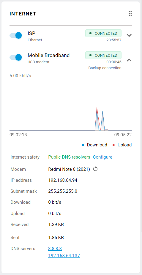

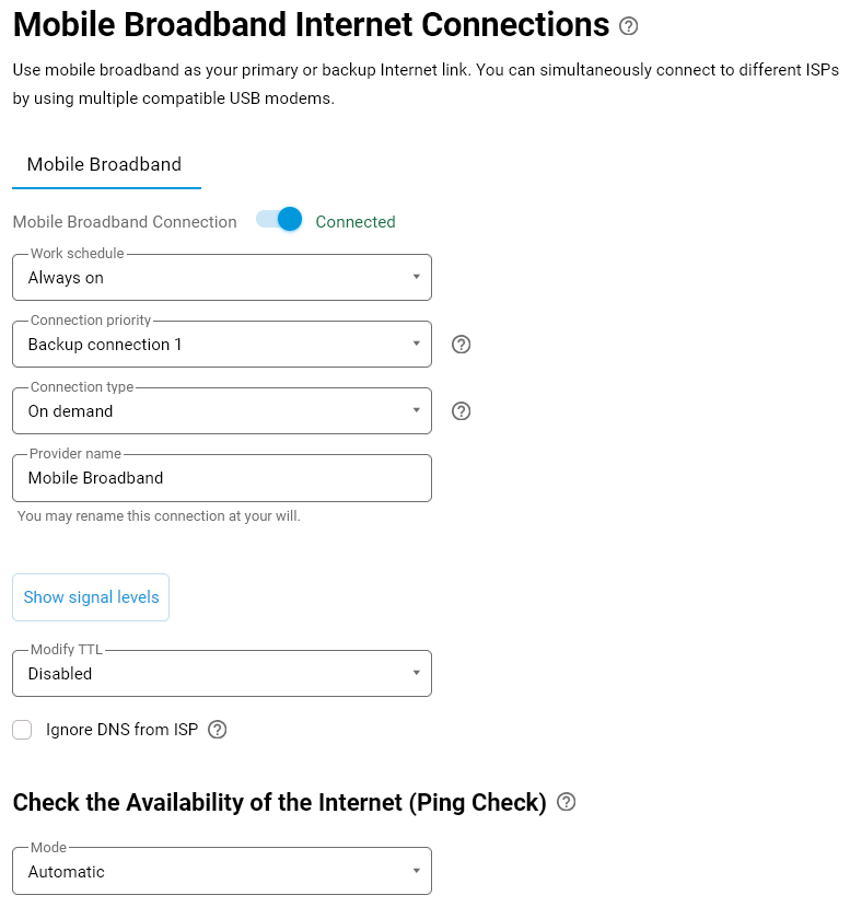

When you connect your phone in this mode to the router's USB port on the Mobile Broadband Internet Connections page, you will see a new connection automatically created. In our example, it is the Mobile Broadband.
Ensure the connection is switched on. Select either Default or Backup in the Connection priority field. If this is your only connection for Internet access, set it to Default, and specify Backup if you plan to use this connection only as a backup channel, which will be activated only when there is no Internet on the primary link.
After changing the settings, press the Save button.
Now check the Internet access on the devices in your home network. In this case, the Internet connection is made over the phone (through the mobile phone operator's network).

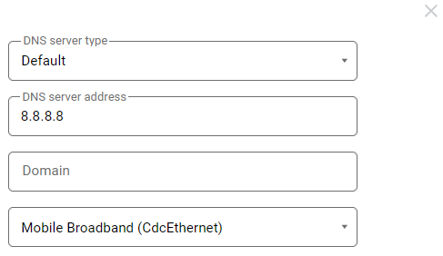

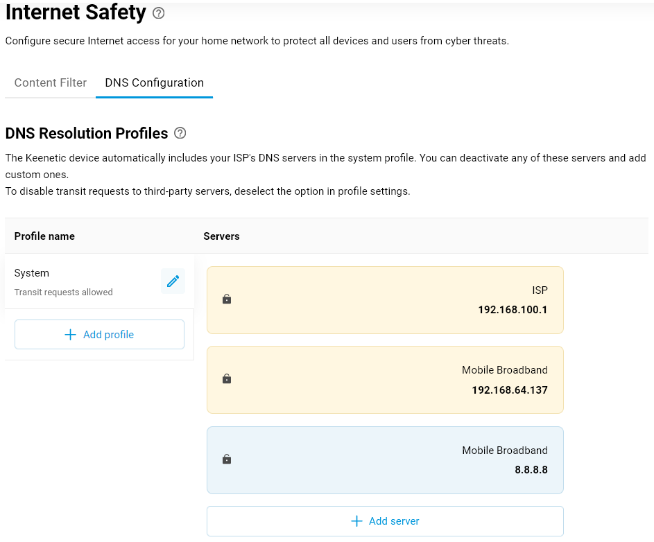

If sites do not open through the router, try adding additional DNS servers. You can do this on the Internet Safety page under DNS Configuration tab. In our example, a public DNS server from Google has been added for the Mobile Broadband (CdcEthernet) connection.
