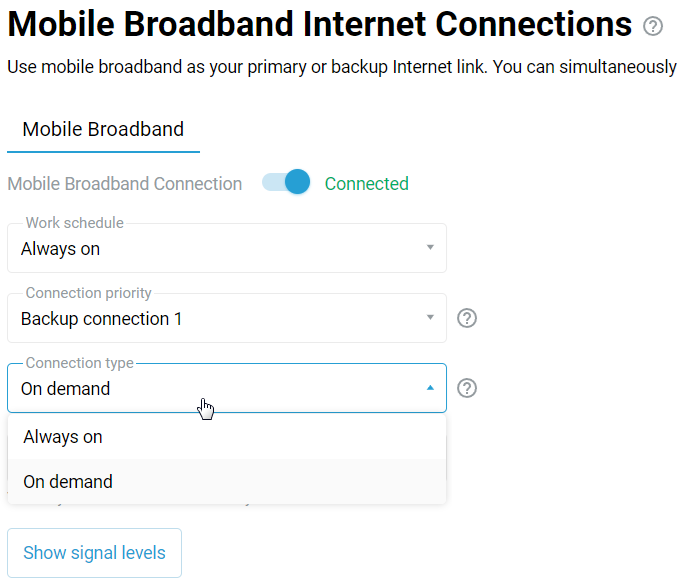

Standby (on-demand) mode can be set for backup connections of wired (via CLI) and wireless interfaces via the web interface in the Connection type section.
Or set up via Command-line interface (CLI) command for Standby mode.

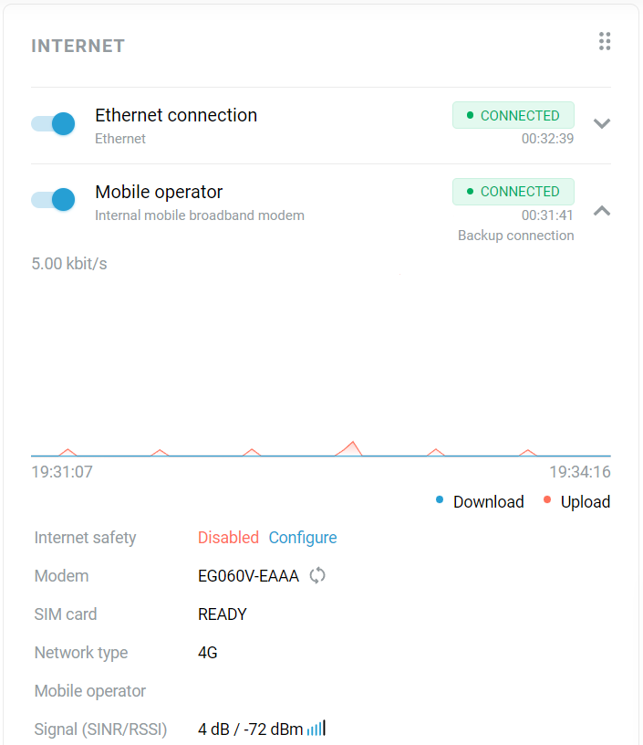

The Standby (on demand) mode is not in use:
The Standby (on demand) mode is on:
