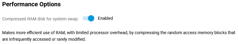

From KeeneticOS 3.7 onwards, zRAM can be enabled in the router's web interface under Management menu on the General System Settings' page under Performance Options.
Set the Compressed RAM disk for system swap switch to Enabled.
