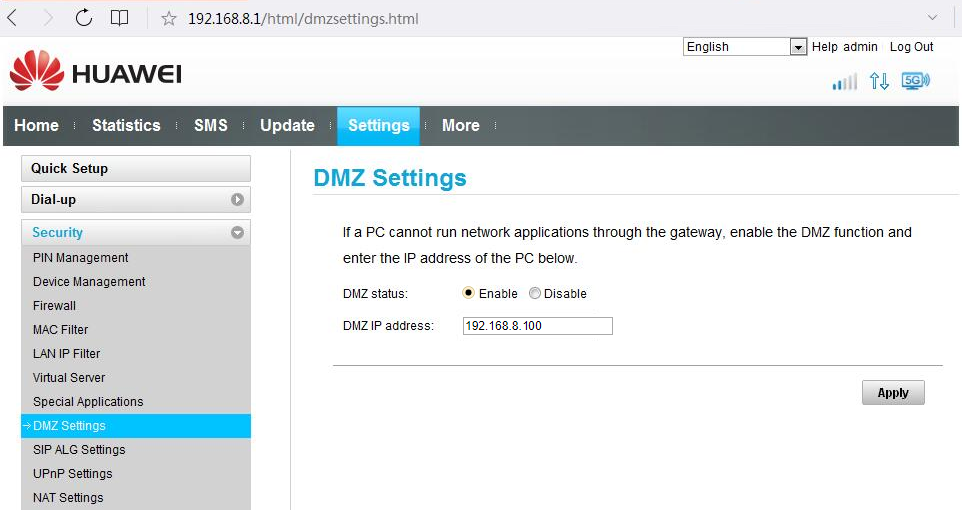

Some USB modems (e.g. in CDC Ethernet mode) operate as routers with NAT and assign their LAN address as the default gateway to the Keenetic router. Even if your operator provides a public IP address, you must still enable the DMZ function in the USB modem settings.
Let's see how to do it using the example of a Huawei modem with HiLink firmware. In the modem web interface (available at 192.168.8.1) in the DMZ Settings section, you need to enable the DMZ function (forwarding of all ports) and specify the address that the Keenetic receives from the modem as the DMZ IP address (in our example, it is 192.168.8.100). It looks like this:

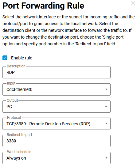

Now, proceed to configuring port forwarding on the Keenetic router. Connect to the Web Interface and go to the Port Forwarding page. Add a port forwarding rule. In the Input field, choose the USB modem interface, and in the Output field, specify the device to which the ports will be forwarded. For more information, refer to the Port forwarding instructions.
