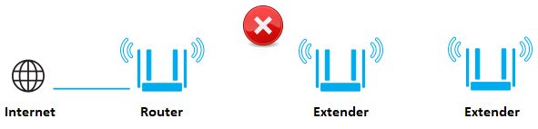

If possible, do not use the Wi-Fi chain connection of Extenders because, in this case, each chain link will have a drop in connection speed.
On the first Extender connected via Wi-Fi, the speed will drop by half; on the second Extender, the speed will drop by about four times. This is because the Extender's radio interface functions as both a client and an access point so that each subsequent Extender will save less bandwidth for its clients.

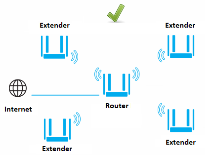

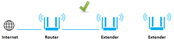

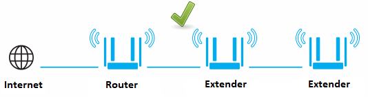

The best way is to connect an Extender to the Main Router or a neighbouring Extender via an Ethernet cable. In this case, the network will work without performance loss.
If running a network cable is impossible, we recommend using a star topology, where all Extenders are directly connected to the Main Router.

If you use Wi-Fi daisy-chain connection, do not connect more than two Extenders in a chain.
