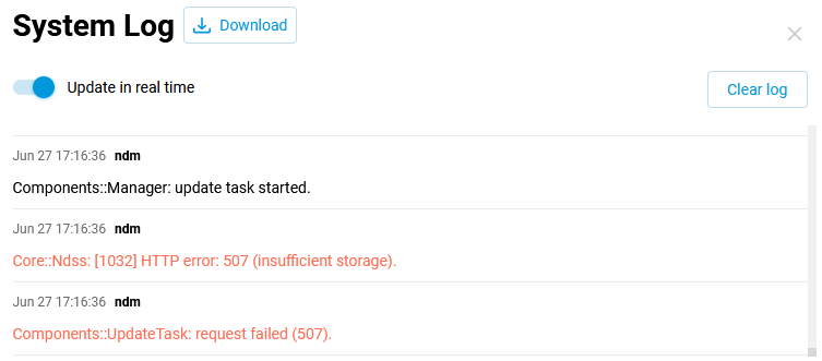

Question: Why can't I update KeeneticOS? A request failed 507 error occurs. The router's system log also contains a message with error number 507: request failed (507) and error:507 (insufficient storage).
  • Answer: Error 507 during an operating system upgrade means that the router does not have enough internal memory to install the selected components. We recommend you uninstall unused components before the update. This is due to hardware limitations. This error may occur on entry models with 32 Mbytes of Flash memory.

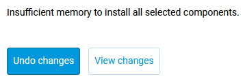

Question: Why can't I install all available components?
  • Answer: Due to the different hardware configurations of Keenetic routers, it is not guaranteed that all components and specific combinations of components available for a particular model can be installed simultaneously. This is usually the case for junior models with up to 32 Mbyte of Flash memory. Also, some operating system components are mutually exclusive and cannot be run simultaneously. We recommend uninstalling the components you do not use and then installing the ones you do need. The recommended set of components can be obtained by installing the KeeneticOS operating system for your router from the Download Center section.
