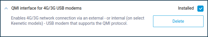

  • QMI interface for 4G/3G USB modems — QMI mode support (UsbQmi).
You can do this in the web interface on the 'General system settings' page under 'KeeneticOS update and component options' by clicking on 'Component options'. Install the specified components (from the 'USB modems and extension modules' section), or make sure they are already installed.

To support this mode, the special component 'QMI interface for 4G/3G USB modems' must be installed which enables USB modems operating in QMI mode.
When you connect the modem to the router, the UsbQmi interface is automatically created in the settings. You can configure the modem further on the 'Mobile broadband connection' page.
