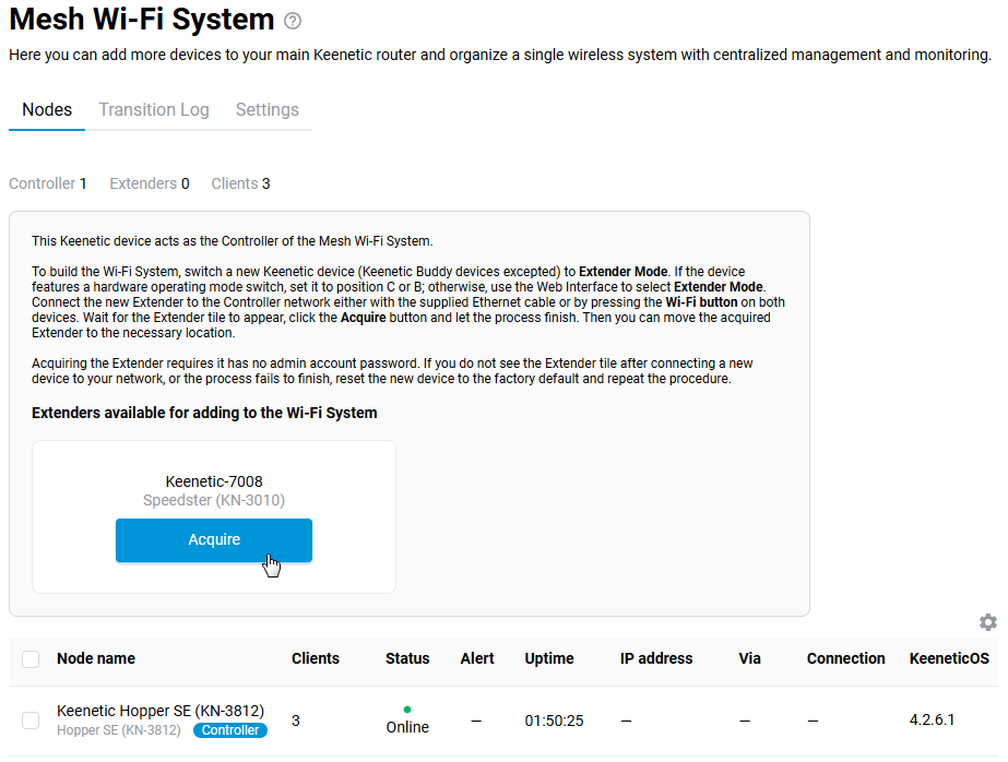

The Сontroller function is to be configured in the web configurator on the 'Mesh Wi-Fi System' page. Once connected, the Extender will appear on the 'Devices' tab in the 'Nodes available for adding to the Wi-Fi system' list.
Before adding a new device to the Wi-Fi system, perform a factory reset on the Extender using the Reset button on the device's body.
The Controller will automatically detect the version of the Extender operating system and, if there is an update, will install the latest version of the device operating system. Click the 'Acquire' button to add the Extender to the Wi-Fi System. Wait for the process to complete.
After a capture, the device will appear in the list of Extenders.

After adding Extender to the Wi-Fi System, you can access its web interface. Click on the Extender's IP address link.

On the 'Mesh Wi-Fi System' page, the 'Devices' tab displays all Extenders - new, available for addition, and previously captured, already part of the Wi-Fi System.
