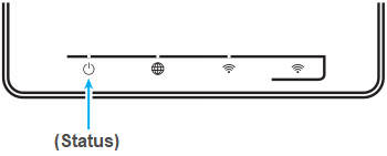

During the reset process, it is important to pay attention to the 'Status' indicator (leftmost), which shows the device state.

Press the 'Reset' button using a sharpened thin object (e.g. a paperclip) and hold it in until the 'Status' LED on the front panel starts frequently flashing (usually it takes 10 to 12 seconds), and then release the button.
After that, the Keenetic will restart with the default settings (factory defaults).
  1. While holding down the 'Reset' button, it is important to wait until the 'Status' LED starts flashing. If you release the button before this moment, Keenetic will reboot without resetting the configuration.
  2. Do not hold down the 'Reset' button for more than 30 seconds, as this will bring the device into emergency recovery mode during reboot. It will wait for the firmware image file to be transferred via TFTP.
