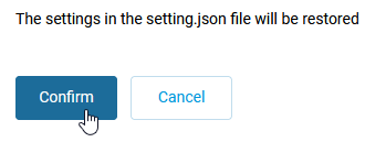

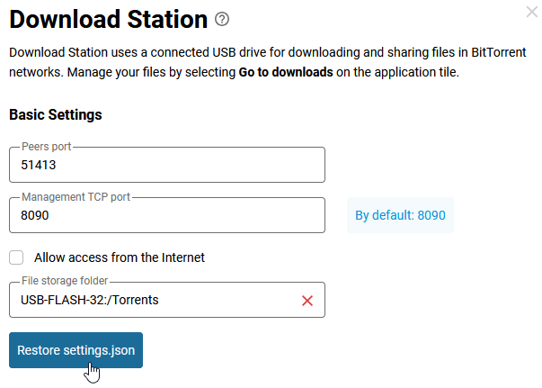

  2. It is also possible to restore the settings.json configuration file to factory settings in the web interface of the Keenetic router.
    To do this, go to the 'Applications' page, click on 'Download Station' and then in the window that appears, click on 'Restore settings.json'

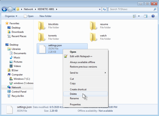

  3. Connect to the USB drive over the network (using Explorer or File Manager) or via FTP.
    Find the configuration file settings.json on it and delete it (in some cases, you may also need to delete dht.dat and stats.json files).
    Then, on the' Applications' page, in the router's web interface, turn the Download Station off and on again. The router will then create a new default configuration file, settings.json. Check the operation of the Transmission torrent client.
