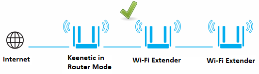

Is it possible to cascade or daisy chain Keenetic devices? Can the connection be made like this: Main Router ↔ Wi-Fi Extender-1 ↔ Wi-Fi Extender-2 ↔ Wi-Fi Extender-3?

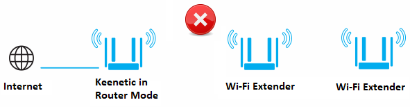

It is possible to chain Wi-Fi Extenders over Wi-Fi, but we do not recommend using this type of networking.
Tip
If possible, do not use
the Wi-Fi chain connection of Extenders because, in this case, each chain link will have a drop in connection speed.
On the first Extender connected via Wi-Fi, the speed will drop by half; on the second Extender, the speed will drop by about four times. This is because the Extender's radio interface functions as both a client and an access point so that each subsequent Extender will save less bandwidth for its clients.
Note

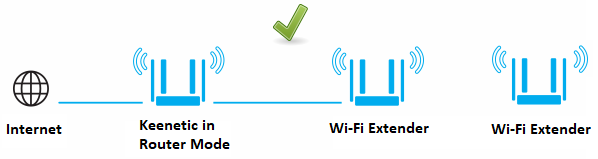

The best way is to connect an Extender to the Main Router or a neighbouring Extender via an Ethernet cable. In this case, the network will work without performance loss.

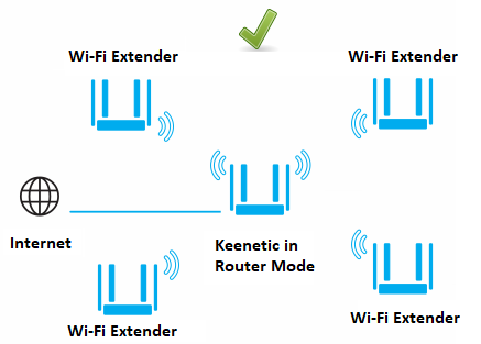

If running a network cable is impossible, we recommend using a star topology, where all Extenders are directly connected to the Main Router.

If you use Wi-Fi daisy-chain connection, do not connect more than two
Extenders in a chain.
