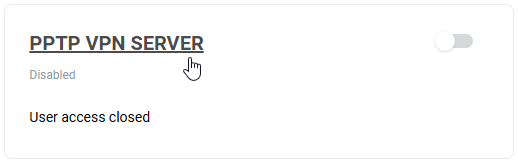

Then go to the 'Applications' page. Here you will see the PPTP VPN server panel. Click the 'PPTP VPN server' link.

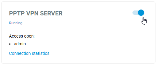

After configuring the server, set the switch to the 'Enabled' state.

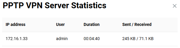

By clicking on the 'Connection statistics' link, you can see the connection status and additional information about active sessions.
