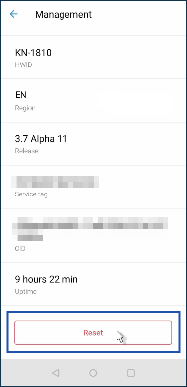

You can reset your router through the Keenetic mobile app. To do this, establish a connection with the router within the home network and run the application.
In the Keenetic app, in the router settings, go to the 'Management' menu and at the bottom of the screen, click 'Reset'.
