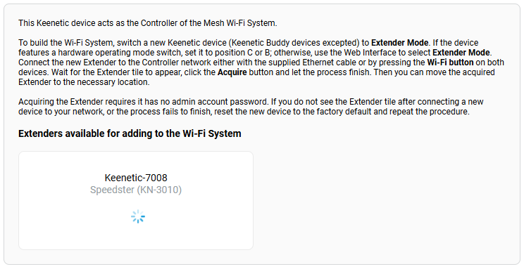

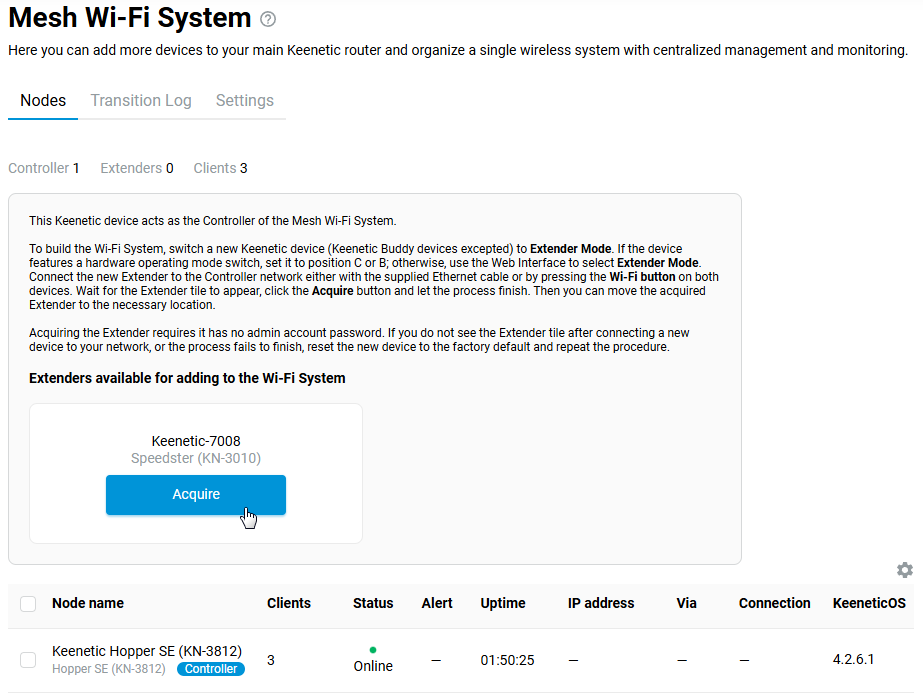

The Сontroller function is to be configured in the web configurator on the 'Mesh Wi-Fi System' page. Once connected, the Extender will appear on the 'Devices' tab in the 'Nodes available for adding to the Wi-Fi system' list.
Before adding a new device to the Wi-Fi system, perform a factory reset on the Extender using the Reset button on the device's body.
The Controller will automatically detect the version of the Extender operating system and, if there is an update, will install the latest version of the device operating system. Click the 'Acquire' button to add the Extender to the Wi-Fi System. Wait for the process to complete.

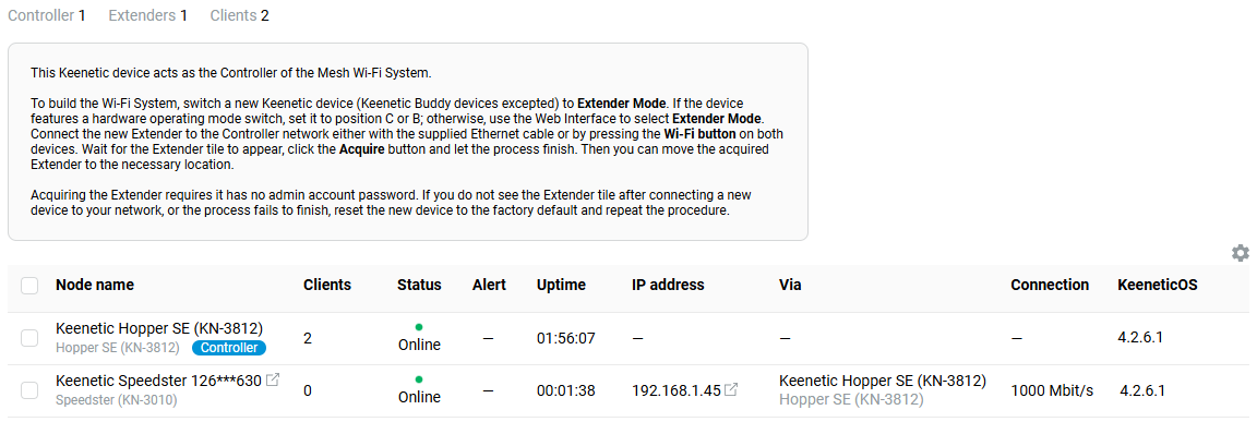

After a capture, the device will appear in the list of Extenders.

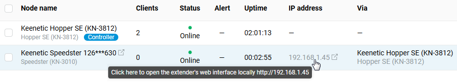

After adding Extender to the Wi-Fi System, you can access its web interface. Click on the Extender's IP address link.
When connecting to the Extender interface, use the administrator account password set on the Controller.

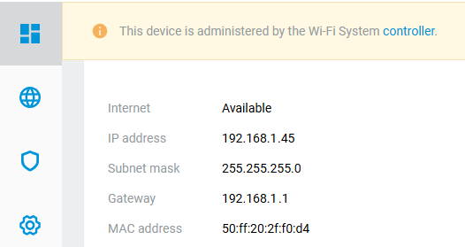

When you connect to the web interface of the Extender, you will see the message 'This device is administered by the Wi-Fi system controller'.
On the Extender, the basic wireless network settings — 'Network name (SSID)', 'Network protection' (security protocol), 'Password' (security key), seamless roaming settings, number of the wireless channel (if the Extender is connected by Mesh Wi-Fi technology), IP parameters, access control lists (White / Black) will not be available for editing. They can be changed only on the Wi-Fi System Controller (Main Router).

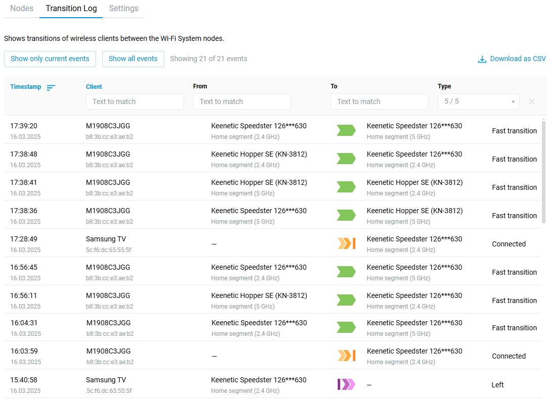

The 'Transition log' tab displays transitions of wireless devices between the Wi-Fi System members. The following events are registered:
Connection;
Left;
Transition (standard transition without 'accelerators', the client disconnected from one point and connected to another);
PMK cache transition (fast transition using PMKID cache, Pairwise Master Key Identifier);
Fast transition (the fastest transition with 802.11r and FT mode).
When the transition log is overflowed, you can use the filter.
