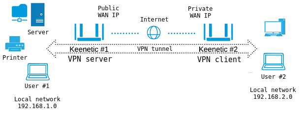

Suppose that Keenetic#1 router is connected to the Internet via an ISP that provides a public IP address. This router has a VPN server (L2TP/IPsecPPTPSSTP) enabled.
Keenetic#2 router has Internet access via ISP, which provides a private IP address.
The Keenetic router, which runs the L2TP/IPsec or PPTP VPN server, must be connected to the Internet with a public IP address, and when using a KeenDNS domain name, it must be configured in the 'Direct access' mode. If any of these conditions are not met, connecting to such a server from the Internet will be impossible.
As for the SSTP tunnel, its main advantage is its ability to work through the cloud, i.e. it allows establishing a connection between the client and the server, even if there are private IP addresses on both sides of the tunnel.
Router Keenetic#2 automatically establishes a connection to the VPN server (Keenetic#1), which allows users of its local network (User#2) to access both Keenetic#1 (to connect to USB drives and printers), and local resources — computers, NAS servers and so on.
After implementing the following setup, the same access will become possible in the opposite direction, i.e. to Keenetic#2 local network from Keenetic#1 local network. For example, User#1 can access files located in the shared folder of User#2.

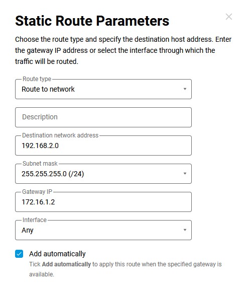

For the VPN server's local network clients to have access to local network resources behind the VPN client, you need to add a static route indicating the location of the client's network. In our example, the local network 192.168.2.0/255.255.255.0 will be available through the IP address given by the VPN server to the connected client (in our case, it will be the client with IP address 172.16.1.2).
On the Routing page, click Create route. In the Static Route Parameters window that appears, select Route to network in the Route type field. In the Destination network address field, specify the remote subnet you want to organize access to and which is on the VPN client side.
In the Gateway IP field, enter the IP address of the VPN client provided by the VPN server during the connection. In the VPN server settings, turn off the Multiple entry option and define a permanent IP address for the VPN client. You can do this on the VPN server settings page in the Users section.
When setting up a static route, you should enable the Add automatically option and leave Any in the Interface field.
Once you add a route, it will not work immediately. You will need to reconnect the VPN tunnel. Disconnect the VPN connection and then activate it again.

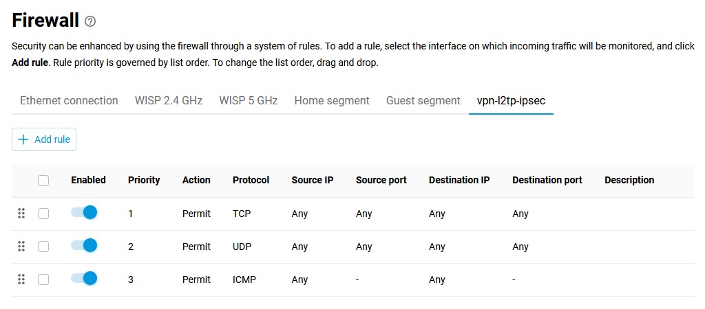

  2. Since the default firewall on the Keenetic#2 VPN client interface blocks all incoming connections to the local network (in our example, the 192.168.2.X network), it requires opening the ports/protocols needed for the work.
    On the Firewall page, select the interface on which incoming traffic will be tracked from the list (this is a VPN connection), and click Add rule to create access rules for any protocols (as a rule, it will be enough to open access via TCP/UDP/ICMP protocols).
