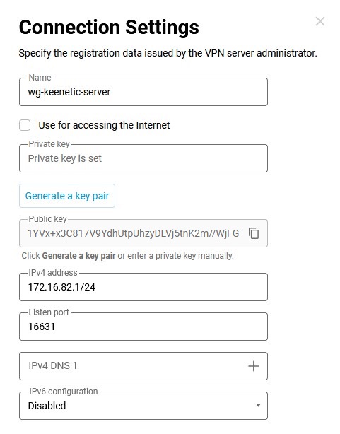

First, you need to configure the WireGuard server on the Keenetic device. The following instruction shows the process: Configuring a WireGuard VPN between two Keenetic routers. Then move on to the VPN client setup.

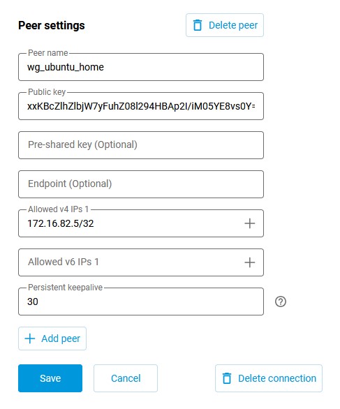

  5. Set up a remote connection on the side of the previously configured WireGuard server.
    Connect to the router's web interface and go to the Other connections page in the Internet section. Click on the previously created WireGuard connection (wg-keenetic-server) and add the peer's settings. Click on Add peer to open the peer settings window, in which you specify the name of the tunnel wg-ubuntu-home.
    In the Public key field, insert the key created in step 2.
    As a reminder, the key can be viewed with the cat command:
    [my@my-wrk-lnv wireguard]$ sudo cat public-key
    xxKBcZlhZlbjW7yFuhZ08l294HBAp2I/iM05YE8vs0Y=
    In the Allowed v4 IPs field, specify the address from which traffic will be allowed to the server in IP/bitmask format — 172.16.82.5/32
    In the Persistent keepalive field, you must specify the frequency of attempts to check the availability of the remote side of the connection. Usually, a 10-15 second interval between checks is enough. The default value of the Persistent keepalive in the Keenetic peer settings is 30 seconds.
    Click Save.

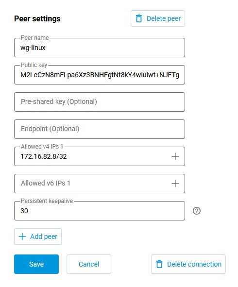

  2. Copy the Private key and paste it into the Private Key field of the tunnel settings:
  3. Copy the public key and paste it into the previously configured WireGuard server in the Public Key field.
    In the Allowed v4 IPs field, specify the address from which traffic will be allowed to the server in IP/bitmask format — 172.16.82.8/32
