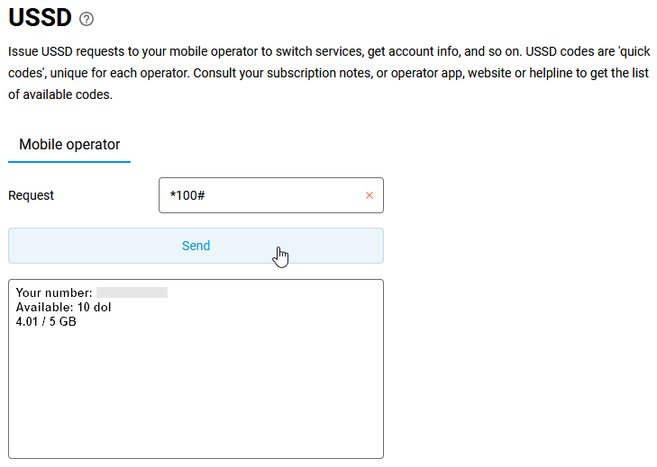

In the web interface, in the Internet menu section, click on USSD. Enter the USSD command (request code) in the Request field and press the Send button.

Example of a USSD request command:
(config)> ussd UsbQmi0 send *100#
request: *100#
response: Your number: +1234567890
Available: 10 dol
4.01 / 5 GB
