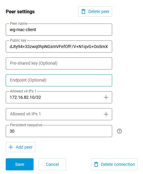

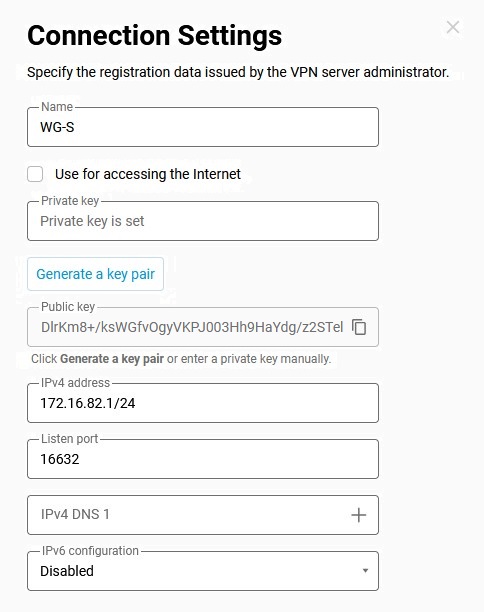

    Connect to the web interface of the Keenetic router and go to the InternetOther connections menu. Click on the previously created WireGuard connection (WG-S) and add Peer settings. Clicking on Add Peer will open the Peer Settings form, where you will enter the name of the tunnel wg-mac-client.
    In the Public Key field, insert the key generated earlier in step 2 of this article.
    In the Allowed v4 IPs field, specify the address from which traffic will be allowed to the server in IP/bitmask format — 172.16.82.10/32.
    In the Persistent keepalive field, specify the frequency of attempts to check the remote connection side's availability. Usually, a 10-15 second interval between checks is sufficient. By default, the Persistent keepalive value in peer settings is 30 seconds.
    Click Save.

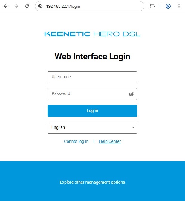

    Check the availability of the server web interface (in our example, it is a Keenetic with IP address 192.168.22.1).
