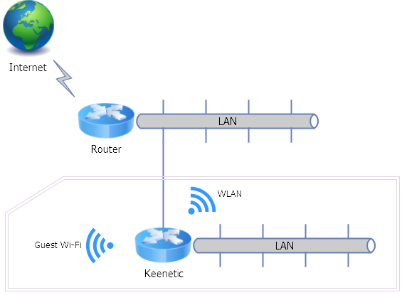

Let's assume that a router is installed at a facility, through which the local network accesses the Internet via an Ethernet cable. Using an additional Keenetic router, you need to expand the existing network and organize access by connecting clients via Ethernet cable and Wi-Fi, as well as create a guest Wi-Fi network.
This example considers a 'non-standard' scheme and operating mode for a case where there is already an existing network with Internet access. For example, this could be a corporate local network ('enterprise network'). The Keenetic router will act as a regular access point for the main network, and a guest network will be set up on it, with IP addresses assigned by this Keenetic router itself, and packets from the guest network forwarded to the higher-level network via NAT.
We will use Keenetic Hopper (KN-3811) as the additional router. The network to which it needs to be connected has its own gateway with the address 192.168.101.1 (which also serves as the DNS and DHCP server) and a network mask of 192.168.101/24. We will leave one switch port working in the preconfigured Home segment, while the other ports will be used in the enterprise network. In addition, the device will provide a wireless connection within the enterprise network, as well as a guest network (isolated from the enterprise network).

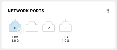

2. In the web interface, on the System Dashboard page, identify the port to which the computer is connected.
In our example, this is port number 3.

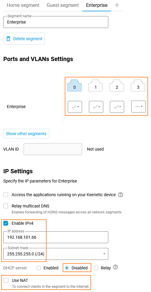

Go to the My networks and Wi-Fi page and add a new segment to the device's local network.
In the settings for the new segment, you will need to specify the use of ports other than the one to which the computer is currently connected.
In the IP Settings section, specify a unique IP address in the enterprise network that will not be assigned to another device, disable the DHCP server in this segment (since the enterprise network already has its own server), and uncheck Use NAT.
At this stage, you should also enable the wireless network for this segment and configure the connection parameters as required. This is because in the next step, we will execute commands that will hide the settings for this segment from the web interface.
Save the settings.

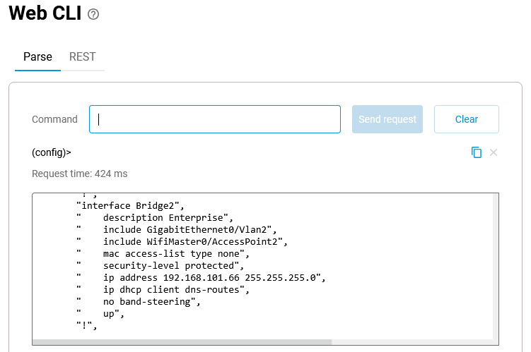

3. Further actions must be performed using commands. The router's command-line interface (CLI) also works through the web interface (Web CLI).
Run the show running command to display the current router configuration:

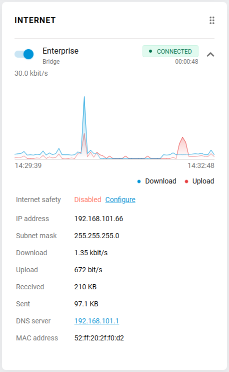

4. On the System Dashboard page, the Internet panel now displays the following information:
