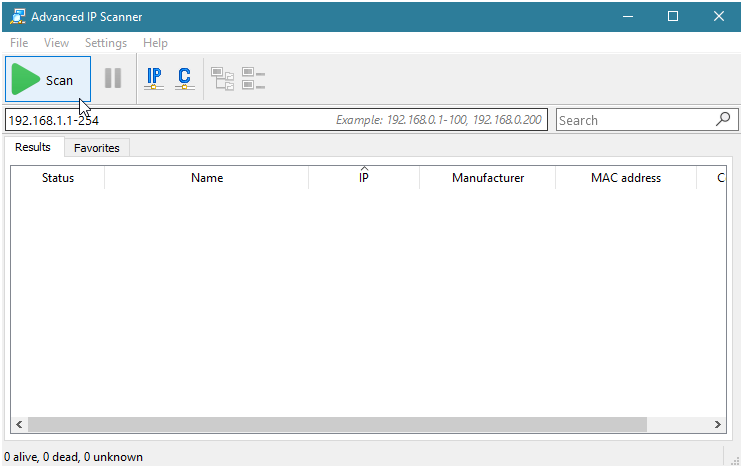

Launch the app and press the Scan button to search for local network devices.

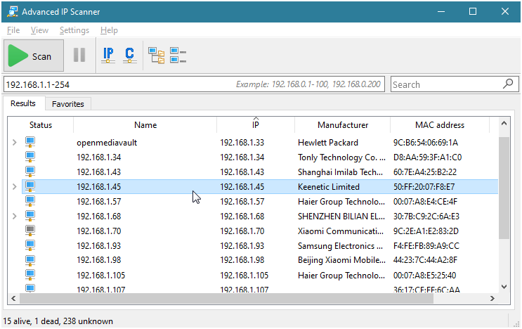

After performing a local IP range scan, the application will show the detected active network devices in the Results tab. For Keenetic, the Manufacturer column will show Keenetic Limited, and the IP column will show the router's local address on the network. In our example, Keenetic has an IP address of 192.168.1.45.
Now connect from your browser to the web interface using the IP address of the extender.
