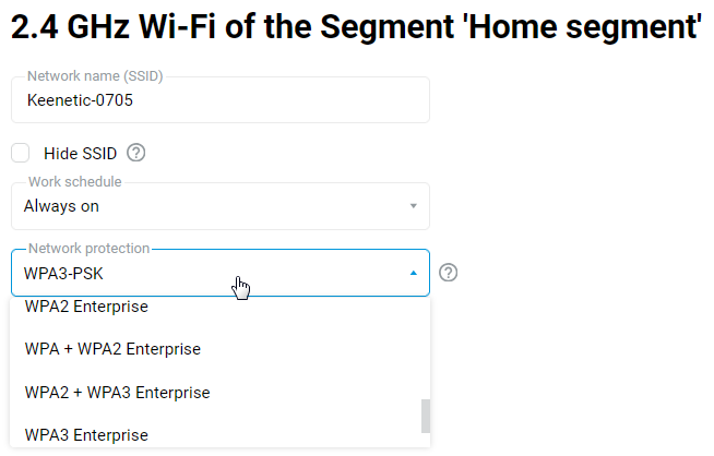

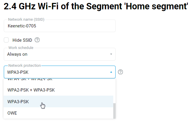

WPA3-PSK and OWE configuration is available in the router web interface in the 2.4 and 5GHz 'Wireless Network' settings on the 'My Networks and Wi-Fi' page. Locate the 'Network protection' drop-down and select the appropriate algorithm for your network.
To use the new WPA3-PSK and OWE network protection mechanisms, the connected device must support these algorithms in the driver of its radio module.

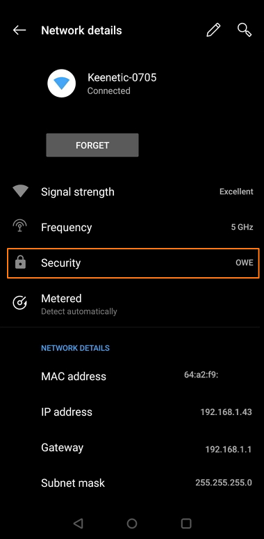

Below are some examples of connection on a Oneplus 6 smartphone (Android 9).
WPA3-PSK network protection (SAE):
OWE open network protection:
To use the WPA Enterprise protocols, you need to install the 'WPA Enterprise' system component. You can do this on the 'General System Settings' page by clicking on 'Component options'.
After that, you will be able to configure the WPA Enterprise protocols in the Wi-Fi settings.
