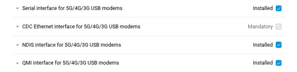

For compatible USB modems to work, you must first install the four system components in your router:
Serial interface for 4G/3G USB modems — RAS mode support (
UsbModem
);CDC Ethernet interface for 4G/3G USB modems — CDC Ethernet mode support (
CdcEthernet
);NDIS interface for 4G/3G USB modems — NDIS mode support (
UsbLte
);QMI interface for 4G/3G USB modems — QMI mode support (
UsbQmi
You can do this in the web interface on the 'General system settings' page under 'KeeneticOS update and component options' by clicking on 'Component options'. Install the specified components (from the 'USB modems and extension modules' section), or make sure they are already installed.
For more information on Keenetic router system components installation, see KeeneticOS components installation/removal.
