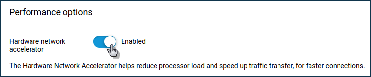

Starting from KeeneticOS 3.7 in the router's web interface on the 'General system settings' page in the 'Performance options' section, there is a switch to enable/disable the hardware accelerator.
