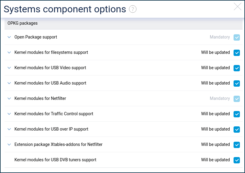

  2. Install the OPKG components.

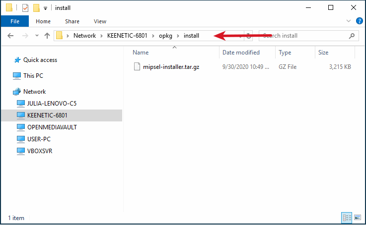

    In the root folder of the hard disk partition with the EXT4 file system, you need to create the install directory where you download mipsel-installer.tar.gz.
    Then disconnect the hard drive from your computer and connect it to the router.
