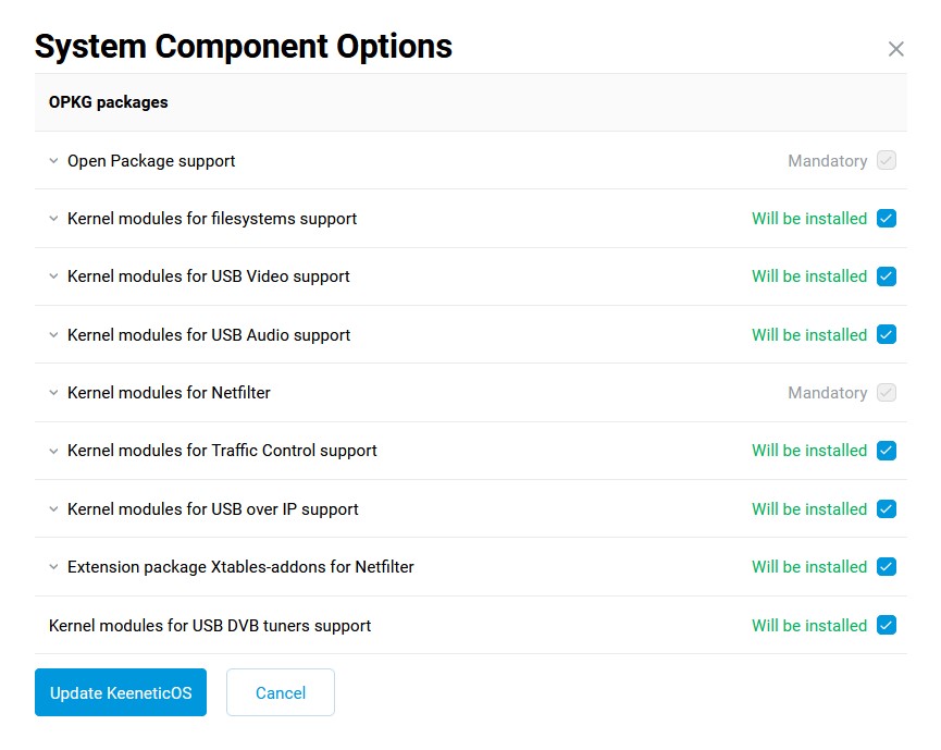

  2. In your Keenetic router, install the required OPKG components. The primary and mandatory one is the Open Package support component.

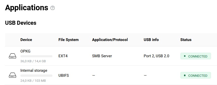

    Plug the USB drive with the ext4 file system into the router's USB port. The drive should appear on the Applications page under USB Devices.

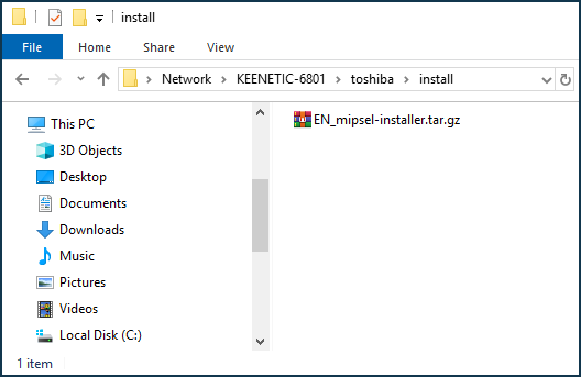

    Use a file manager to connect to the drive via the network (in Windows, you can use Explorer). In the router's settings, the SMB server application must be enabled in advance to access USB disks that you connect over the network.
    Create an install directory in the root of the disk partition where you put the file mipsel-installer.tar.gz.

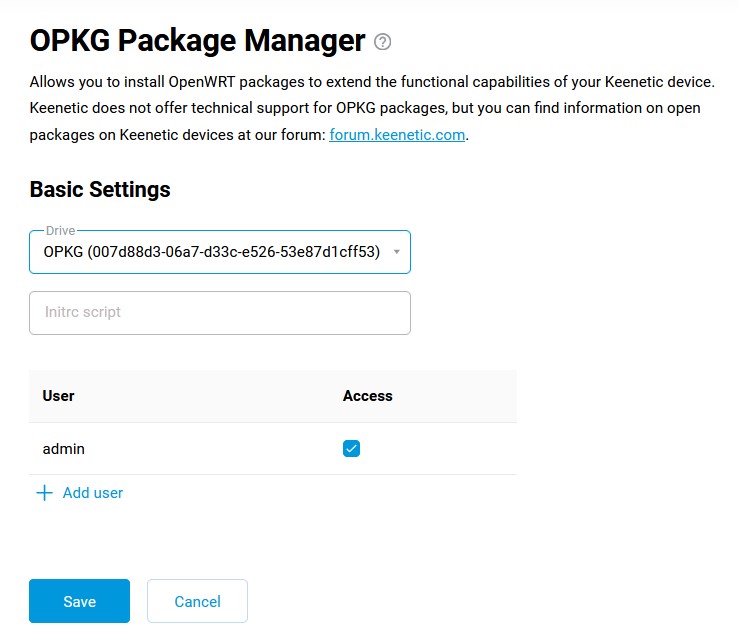

  5. Go to the OPKG Package Manager page and select the ext4 drive you have prepared in the Drive field.
    Click Save.
