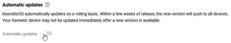

  3. Automatic update function (enabled by default, can be disabled).
    The function sends a request to the server via a secure HTTPS protocol to build the operating system in the required configuration for the device, then receives the resulting file and updates it in the device memory with the subsequent reboot. The frequency of official releases is about 6-10 times a year. The amount of traffic depends on the number of operating system components. On average, when using the recommended set, the download size ranges from 8 MB (for entry-level models) to 20 MB (for advanced models).
    You can disable the automatic update function in the web interface, on the General System Settings page, under KeeneticOS Update and Component Options. In this case, the device will not perform the update without your participation.

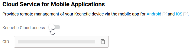

  5. Service for mobile application (enabled by default, can be disabled).
    The module provides remote access to the device from the Keenetic mobile application. Every 30 seconds, it reports to the cloud controller on the Keenetic Cloud servers. The module only starts sending data when there's a device added to your account. Data sent consists of system events (Internet connection change, router restart, etc.) and telemetry on traffic, CPU and memory load. The data is transmitted in encrypted form using the AES and Curve25519 technologies and is stored in compliance with the legislation on protecting personal data. Daily traffic is about 40 MB when added to the cloud service.
    If you are not using remote access to the router via the mobile app, disable the Keenetic Cloud service to reduce service traffic. You can do this in the web interface, on the General System Settings page, under Cloud Service for Mobile Applications.
    To completely disable the Keenetic Cloud service, remove the Service for mobile application component from your device's operating system. You can do this on the General System Settings page, under KeeneticOS Update and Component Options, by clicking Component options.

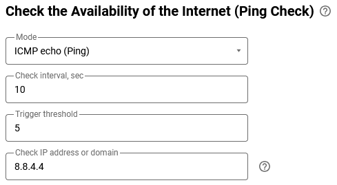

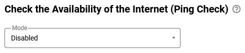

  7. Network connection status checking (Ping Check) (disabled by default, turns on automatically only when a USB modem is connected; otherwise, it is turned on by the user).
    Ping Check can be used to help ensure connection redundancy and features automatic power control of USB modems. Module operation is entirely configurable via its parameters: the checking type (ICMP requests or TCP port check), the interval between checks, and the number of failed checks.
    When using the default Automatic check mode, the module polls the server with the Check interval (time in seconds between checks) of 10 seconds. The default value of the Trigger threshold (number of unsuccessful checks) is 5. The module establishes DNS/53 + TCP/443 connection without transferring data. One request is 650 bytes, which is 5.5 MB per day or 170 MB monthly.
    You can disable Ping Check via the web interface on the connection type page (Mobile, Ethernet, Wireless ISP, DSL connection) on which it is enabled. Under Check the Availability of the Internet (Ping Check), set the Mode field to Disabled.
    If you want to leave Ping Check enabled, you can use ICMP protocol to reduce service traffic. ICMP requests will be less in traffic volume: one request will be 200 bytes, which is 1.62 MB per day or 50.22 MB per month.
