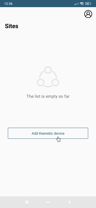

  4. After successfully logging into the account, you need to Add Keenetic device to the app.
    1. If the router is not already configured, make the initial connection and configure the router via the web interface.
    2. If the router is already connected to your ISP's network and has Internet access, follow the Adding a router locally instructions to add the router.
      Click on the entry of the discovered device.
      To connect to the router settings, use the router administrator name (admin) and password as in the web interface. Then click Add.
      The router's administrator password is not set by default; it is set by the user during initial configuration. If you do not know or have forgotten the administrator password, in this case, perform a factory reset using the Reset button on the router.
      If you successfully connect to Keenetic, it will be added to the application.

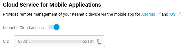

    • Make sure that the system component Service for mobile application is installed. You can do this in the web interface on the General System Settings page in the Update and Component Options section by clicking on Component options.
    • Make sure that Netcraze Cloud access is enabled.
      This setting can be found in the Cloud Service for Mobile Applications section on the General System Settings page.
