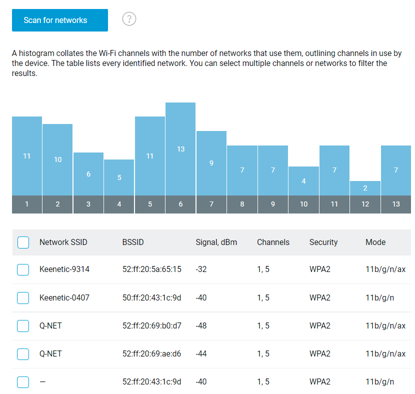

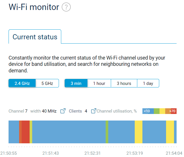

New Wi-Fi monitor and network scanner to see what's going on in the air.

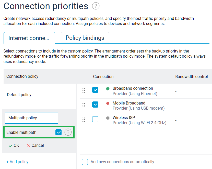

The multipath routing policy option to optimize the usage of multiple Internet connections, speed up and balance the traffic.

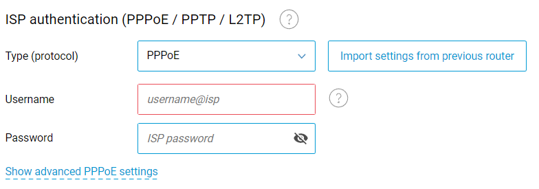

An easier internet connection setup with the option to retrieve the previous router's username and password for PPPoE connection.

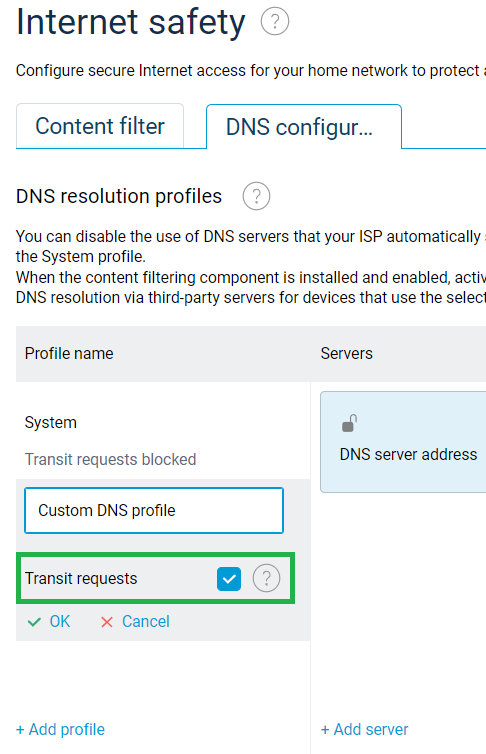

The Transit requests option now operates correctly for all available DNS resolution profiles. [NDM-2403]

The new Enable multipath option is now available on the Connection priorities page. You can automatically balance the throughput among included connections by switching the custom Connection Policy to the Multipath mode. [NWI-1328]

The new Transit requests option of the DNS profile allows profile-linked devices to resolve domain names via the DNS servers requested by the device instead of forcing the resolution via DNS servers specified in the profile. [NWI-1130]

The new Scan for networks feature provides detailed and graphical information about the networks in the air at the Wi-Fi monitor page. [NWI-1280]

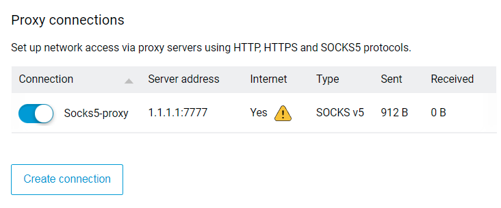

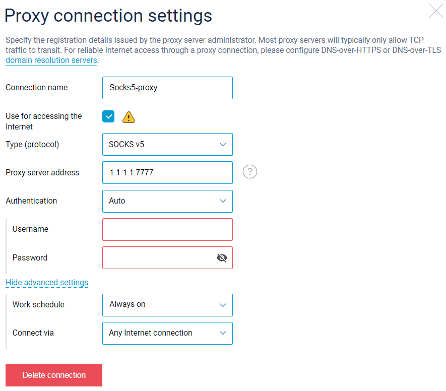

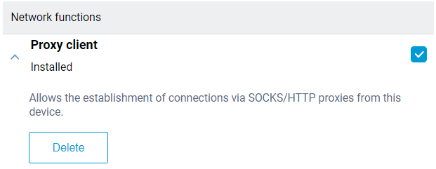

The new Proxy client is available now as a KeeneticOS system component providing Internet access via proxy servers using HTTP, HTTPS and SOCKS v5 protocols. [NDM-2195]
The following CLI commands are available to configure the Proxy client component:
interface Proxy0 proxy protocol (socks5 | http)— choose the protocol type for the proxy connection;interface Proxy0 proxy upstream {host} [{port}]— set address and port for proxy service, enter{host}value as<fqdn>or<IP>;interface Proxy0 authentication identity {identity}— set proxy authentication username;interface Proxy0 authentication password {password}— set proxy authentication password;interface Proxy0 proxy connect [via {via}]— choose interface for proxy connection.
The Proxy connection section is available in the Other connections menu for Internet access via HTTP/HTTPS/SOCKS5 proxy. [NWI-1108]

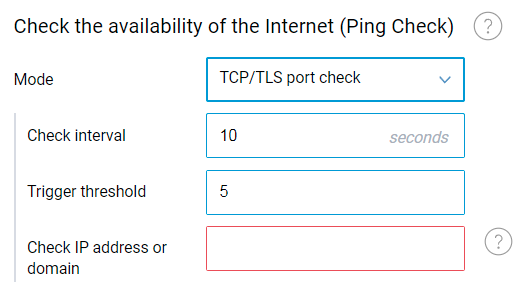

The new TCP/TLS port check mode enhances the Ping Check feature to provide verified protection against Internet access failures. This mode will prevent false-positive results if an ISP redirects traffic to a captive portal, for example, a billing service. [NDM-2094, NWI-1109]
Use the following CLI commands to set:
ping-check profile {name} mode tls— enable TLS mode for Ping Check profile{name}
Or set up via the Web Interface for a required interface:
The new Wi-Fi monitor in the Status section provides a graphical utilization display for the Wi-Fi radio frequency channel currently in use. [NWI-1179]

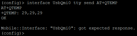

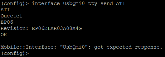

The new AT command terminal for
UsbLte, andUsbQmimodems in the command-line interface (CLI) provides ultimate flexibility for additional modem statistics and configuration options. [NDM-2266]Use the following CLI command:
interface {name} tty send {command} [expect] [timeout]— send AT{command}to a{name}modem interface
For example, here are the results of two AT commands,
ATIandAT+QTEMP, for the Quectel EP06-E modem as aUsbQmi0modem interface.

The Wi-Fi channels used by Keenetic itself are highlighted now on the diagram and table on the Wi-Fi monitor page. [NWI-1389]

The Wi-Fi monitor page has received several design improvements and changes. [NWI-1325]

System and user-defined DNS profiles are now available for assignment from the content filtering profiles drop-down list, along with public DNS presets or commercial services, depending on your configuration. [NWI-1129]
Assigned unconditional priority to user-defined DNS profiles over public DNS presets and cloud DNS profiles. [NDM-2323]
Improved security: the DNS requests from blocked devices are now disabled via the DNS-proxy service of the KeeneticOS. [NDM-2321]

The button to import PPPoE-settings from previous routers now displays correctly in all the languages of the Web Interface. [NWI-1293]
