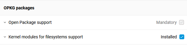

To support this feature, you will need to install the following components:

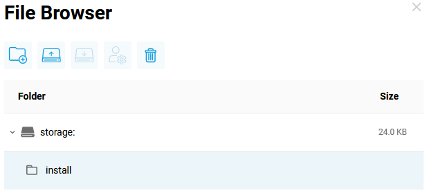

On the Applications page under USB Devices, click on Internal storage and then on the built-in storage partition, create the install folder:

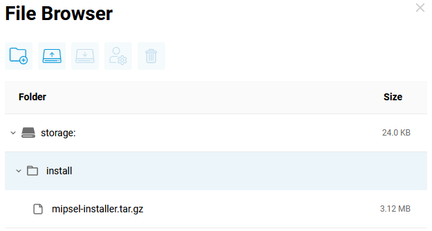

In this folder you need to upload a special archive file, depending on the device:
Note
For Viva (KN-1912) model, use the mipsel archive for installation — mipsel-installer.tar.gz
In our example, we will consider installing the mipsel archive.
