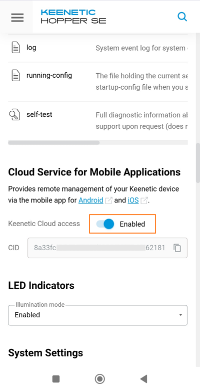

If the connection is successful, you will see the web interface (Control Panel) screen of your Keenetic. Scroll down to the System Update section. The OS version line displays the current version of the KeeneticOS operating system. If an update is available, install it.
Click on
(hamburger icon) in the upper left corner of the screen. The navigation menu will open on the sidebar. Scroll down and go to the System Settings menu.
The switch must be set to Enabled in the Cloud Service for Mobile Applications section.
