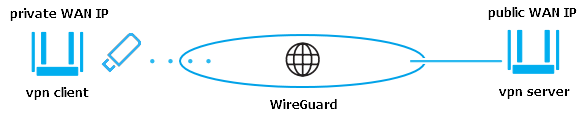

Let's consider the option of configuring access to the web interface of a 5G/4G/3G USB modem that has its own management interface at 192.168.8.1 and is connected to a router that serves as a VPN client. We need to provide access to the USB modem's management interface from the local network of the ‘server’ through the VPN tunnel.
Let's take the WireGuard connection from the article Configuring a WireGuard VPN between two Keenetic routers as an example. After completing these settings, remote networks will be connected using WireGuard VPN, and access to hosts on both sides of the tunnel will be implemented. However, by default, there will be no access to the 5G/4G/3G USB modem interface, since the modem's IP address belongs to its own network (192.168.8.0). Additional settings will be required to access the modem's subnet and, therefore, the address 192.168.8.1.

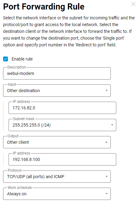

The ip static redirection rule will replace the source IP address when accessing the USB modem, as the source address will be unknown to the modem itself, and it will have to respond via the default route.
The above ip static rule can be created in the web interface of this router on the Port Forwarding page:

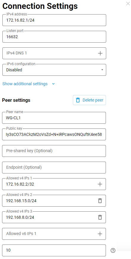

On the Wireguard server side, add the 5G/4G/3G USB modem network 192.168.8.0/24 to the Allowed v4 IPs:

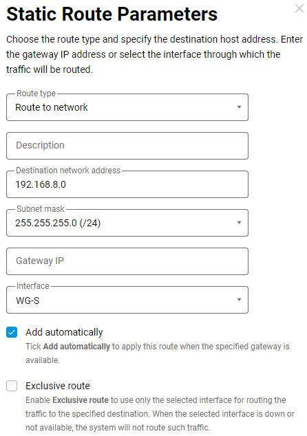

On the WireGuard server side, specify the route 192.168.8.0/24 to the 5G/4G/3G USB modem network:

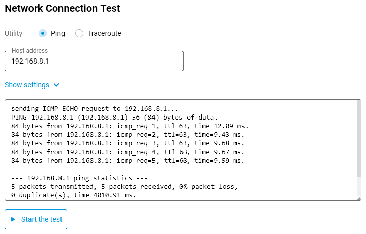

Then, check access, for example, from the WireGuard server on the Diagnostics page, send ICMP requests to the USB modem address:
Now the USB modem's management interface will be accessible through the VPN tunnel.
