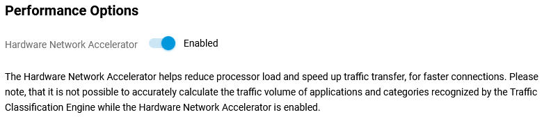

Starting from KeeneticOS 3.7 in the router's web interface on the General System Settings page in the Performance Options section, there is a switch to Enabled/Disabled the hardware accelerator.
