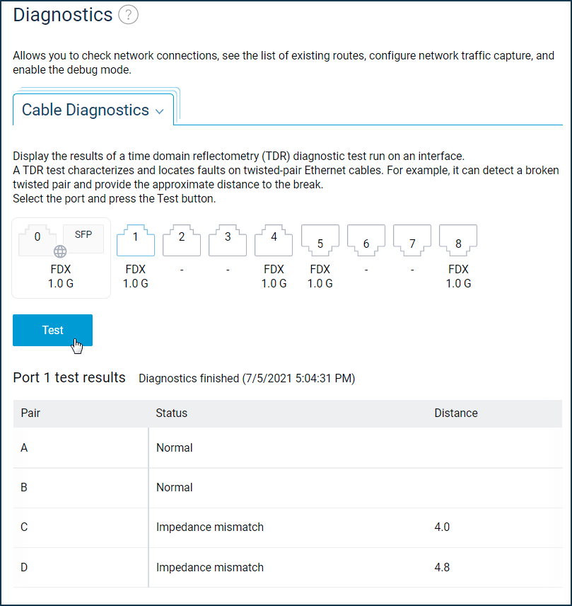

In the router's web interface, go to the Diagnostics menu, select a port on the Cable Diagnostics tab, and click the Test button. The Pulse Reflectometry Diagnostic Test (TDR) results on the selected interface will be displayed below.

The twisted pairs A, B, C, D is equivalent to 1, 2, 3, 4:
