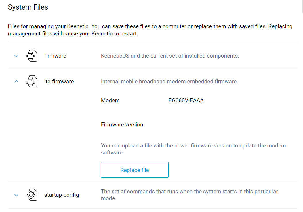

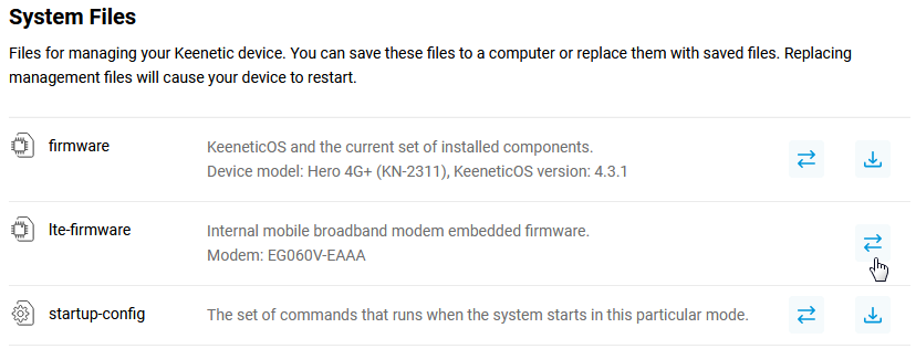

Go to the General System Settings page, and under System Files section, for lte-firmware file entry click on Replace file icon and specify the path to the firmware file of the built-in modem (.bin file).
This will start the process of downloading the file and updating the firmware of the built-in LTE modem.
