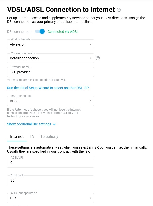

Go to the VDSL/ADSL Connection to Internet page. In the DSL technology field, select ADSL.
Below, specify the settings for your Internet connection.
The VPI, VCI values, username and password for Internet access are usually specified in the contract between a subscriber and ISP.
In the Internet tab, it is necessary to set the values for ADSL VPI, ADSL VCI and ADSL encapsulation. In our example, the VPI/VCI values are 0/35, and the encapsulation is LLC.

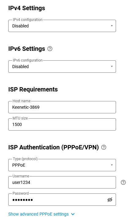

Next, on the same page, in the IPv4 configuration and IPv6 configuration fields, select Disabled, as it is not required to assign an IP address on this virtual channel.
PPPoE authentication will be used to connect to the Internet. In the ISP authentication (PPPoE/VPN) section, specify PPPoE in the Type (protocol) field. In the Username and Password fields, type in the values provided by your ISP for connecting to the Internet.
Click Show advanced PPPoE settings to display the fields with additional parameters.
