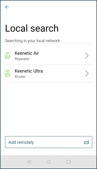

    If you are connected to your router's network, the app automatically searches it for Keenetic devices.
    Tap on the detected device.

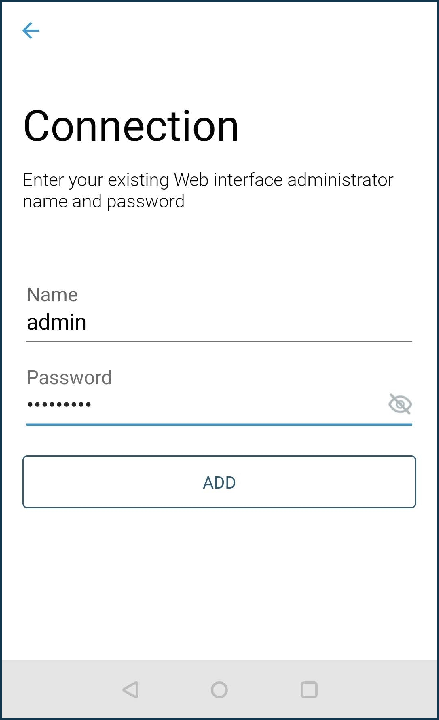

    Use the router administrator name (admin) and password, as in the web interface. Then tap 'Add'.
    By default, no administrator password is set in Keenetic routers. A user must set it during the initial setup. If you do not know or have forgotten the administrator password, use the Reset button on the router to reset it to factory settings.
    If the connection were successful, the router would be added to the app.

Start the application and click 'Add Keenetic' on the Sites screen.
Before you start adding your Keenetic devices, make sure it is turned on and ready to use.
On the 'Local search' screen, click 'Add remotely'.
Enter the CID of your Keenetic or paste it from the clipboard and click 'Search'.
To connect to the Keenetic, use the same router administrator name and password as the web interface. Then click 'Add'.
On successful connection to the router, it will be added to the application.

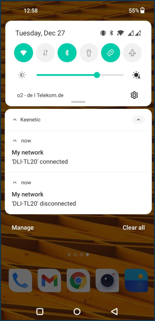

    If the Keenetic application is enabled to receive push notifications when updating the version of KeeneticOS on the router, the mobile device will receive such notification. For example:

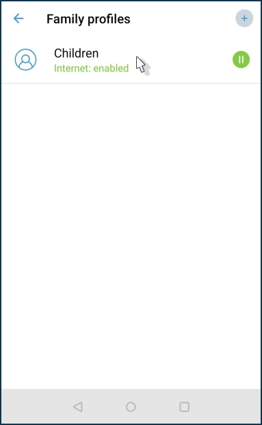

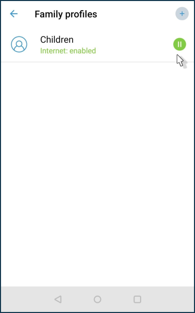

Start the application, and on the 'Sites' screen, tap on the site for which you want to set up the profile.
Tap to 'Family profiles'.
To create a new profile, click on the '+' icon in the upper right corner of the screen and name it (in our example, it's 'Children').
Click on the name of the created profile to proceed to its setting.

On the 'Family profiles' screen, you can quickly, with one switch, deny Internet access to all devices in your current profile. Click on the green 'pause' icon to suspend the profile.
Clicking on the 'play' icon will activate the profile again.

If you want to disable Internet access for a group of home network devices at once, use Family profiles.
If you disable Internet access in the family profile, the schedule will no longer be active. For example:
3 devices added to the profile: a computer, a tablet and a smartphone.
To block Internet access, set the 'Internet' switch to Off.
Switching off the Internet in the family profile will be applied to all devices in the current profile.
To restore access, move the 'Internet' switch to the On position.
A similar setting for switching off the Internet can be made by pressing the 'Pause' icon on the 'Family profiles' screen.
Pressing the 'Start' icon again will re-enable the Internet on the current profile devices.

Setting notifications from your Keenetic
With the Keenetic mobile application, you can set up notifications to receive information about events on the router in a way that suits you best. For example, you can receive notifications about changes in the status of your router (online/offline) or when the router switches to a backup connection.
The following alerts are currently available:
  • Connecting/disconnecting network devices.
  • A new device on the network.
  • The Keenetic device is offline.
    The offline alert comes when no signals are received from the router to the cloud server. For example, it may be because the Internet is unavailable (no connection to the Keenetic Cloud server), the server waits for 10 minutes and then generates a notification.
  • The Keenetic device is online.
    The online alert is received when a signal message from the router appears on the server after the 'Keenetic Offline' event has been triggered. It is generated by the server as soon as the first signal message is received.
  • The device has been booted up.
    The router has been turned on/rebooted.
  • The Internet connection has switched.
    The alert comes when the WAN connection on the router is changed. For example, switching from the main to the backup channel and vice versa.
  • KeeneticOS has been updated.
    The notification comes when the KeeneticOS version on the router is changed.
  • Wi-Fi off / on.
  • The status of the family profile has changed.
    Activating/deactivating the Internet for a family profile.
Security notifications (cannot be disabled):
  • Incorrect Keenetic device password entered to access from the Cloud;
  • A manager has been added to the location;
  • A manager has been removed from the location;
  • Change of encryption key on Keenetic device;
  • A new user has been added to a Keenetic device.
You can receive notifications in the following ways:
  • To an e-mail address;
  • By push notifications (from the Keenetic application on a mobile device);
  • In the Telegram messenger.
Install the Keenetic mobile application and add your device by following the instructions:
android.svg
ios.svg
huawei-market.svg
Launch the app and in the 'Locations' main screen, select the required network.
From the selected network settings screen, press 'Events'.
Click on 'Notifications'.
Select the events for which you want to be notified.
Please tap on the events that you want to be notified of when they occur. Select the notification methods. Tap a checkmark in the upper right corner of the screen to save the setting.
When you enable e-mail notifications, you will receive e-mails to the address you specified when registering your account. For example:
Tip
If you want to set up notifications to different e-mail addresses, you must first create accounts for these addresses on Keenetic Account and then add them as Location Managers.
When push notifications are enabled, they will arrive at your mobile device, where the Keenetic application is installed. For example:
The 'Events' screen keeps a log of completed notifications. To clear the log, press the 'Delete' icon in the top right corner of the screen.
Configuring Telegram notifications
To set up notifications via Telegram Bot (https://t.me/KeeneticNotifierBot), mark the required notifications first.
And then generate a unique code by clicking 'Connect'.
Then go to the https://t.me/KeeneticNotifierBot settings and register the obtained code.
Use the command /register [telegram-code]
For example: /register 2937a360-0d00-11e7-8029-xxxx
Wait for a confirmation message about registration 'Successful registration'.
If you get an 'invalid code' message when registering the key, be sure to run the /unregister command and then register again. Also, make sure you copy the code without any extra characters, such as spaces.
Check the notifications afterwards.

What login and password do I need to enter in the Keenetic app?
android.svg
ios.svg
huawei-market.svg
In the Keenetic mobile app, on the Connection screen, you need to enter the login and password for the administrator (admin) account of the router. This is the same login and password used to connect to the router's web interface through a web browser.
If you see a login screen, this means that a password was previously set in the router. Usually, the password is set during the initial configuration of the router. There is no administrator password in the factory settings.
If you do not remember the password or do not know the password (e.g. the router has not been configured by you), please perform a factory reset of the router.
The administrator password for the router is not set by default (factory default), but is set by the user during initial setup. If you do not know or have forgotten the administrator password, please use the Reset button on the router.
When you perform a reset, all user settings will be deleted. After the reset, you will need to configure the router to connect to the Internet from scratch. Before resetting, ensure you have all the information you need to set up your connection. If you need to know what settings are used to connect to the Internet, contact your ISP to obtain this information.
After the factory reset, configure and connect the router to the Internet. During the setup process, set a password for the router's administrator account.
Then, connect to the Keenetic router's Wi-Fi network. The Wi-Fi network name and password (network key) are printed on the label located at the bottom of the router's case.
When you see the login and password prompt again, enter admin (in small English letters) in the 'Name' field and the router administrator password you set during the initial setup in the' Password' field.
You can change the admin password at any time via the Keenetic app (menu 'Management' > 'Users' > admin) or via the router's web interface.
Remember or save the router administrator password. You will need it later to add the router to the Keenetic app and when you connect to the router's web interface.
