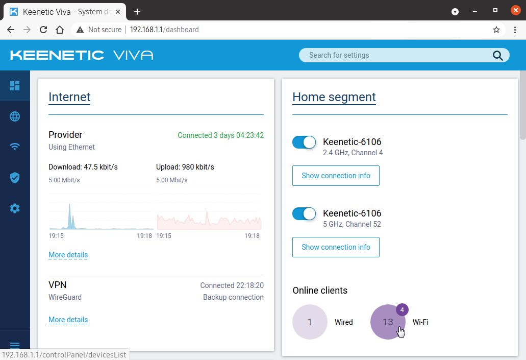

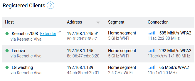

(Internet) indicator on the Extender will light up continuously. The Wi-Fi network settings will be copied from the Main Router.Open the web interface of the Main Router (in our example, it is Skipper). On the System dashboard > Home segment > Online devices section, click on the icon with the number of connected Wi-Fi devices.

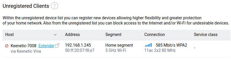

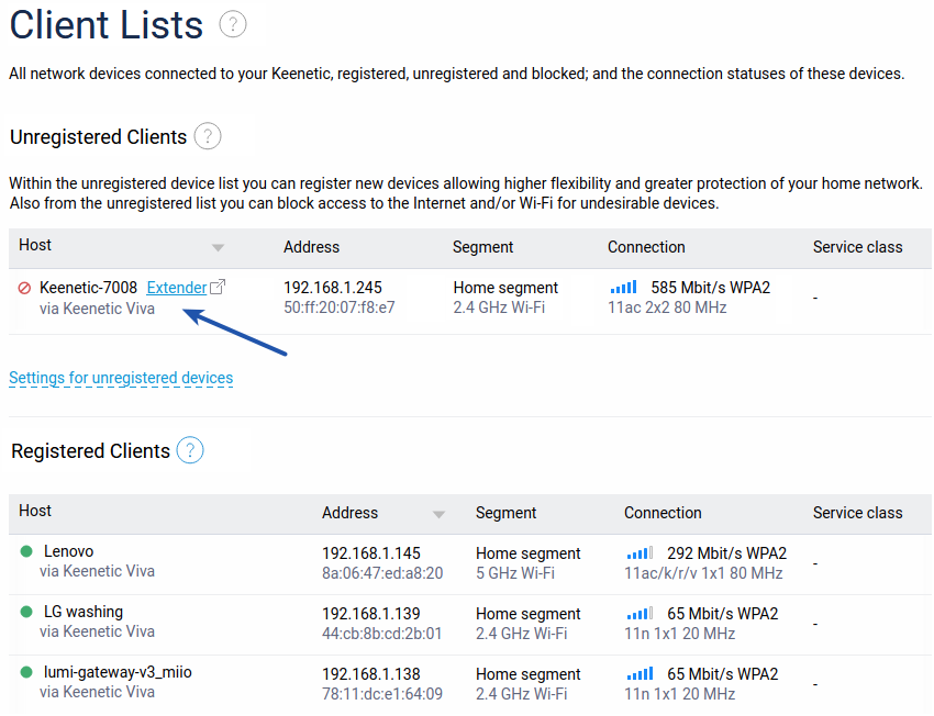

The Device lists screen opens. In the Unregistered devices list, you will see the entry of the connected router in Extender Mode (in our example, Speedster is connected to a 2.4 GHz Wi-Fi network).
Keenetic dual-band models can be connected to a 5 GHz Wi-Fi network on the Main Router. For example:

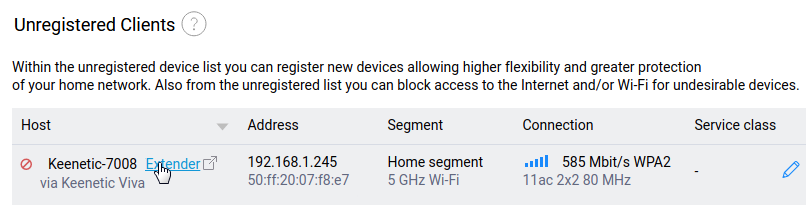

To go to the web interface of the Extender, click on the link near its name.

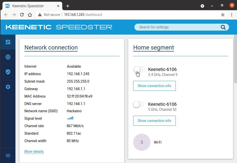

In the Extender's web interface that appears on the dashboard screen, in the Home segment settings, switch off the Wi-Fi network.
Now the device in Extender Mode will work as a Wi-Fi Adapter. To access the Internet, connect your home devices to the network ports of the Extender via an Ethernet cable.

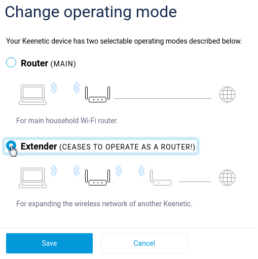

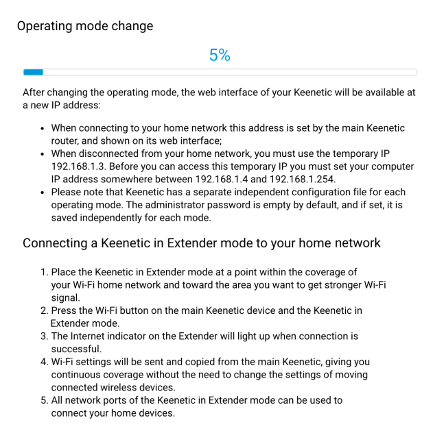

If there is no switch on the router, you can change the mode through the web interface. Go to the General system settings menu, and in the Change operating mode section, click Change operating mode. Select Router and click Save. If for some reason, you are unable to connect to the web interface of the Extender, you can use the reset button on the case. In this case, the factory settings will be restored, and the device will switch to the Router Mode.
Note
Changing the operating mode from the web interface.
If there is no mode switch on the router, you can switch the mode via the web interface.
Go to the General system settings menu, and under the Change operating mode section, click on the Change operating mode button. Select Extender (Repeater/Extender in older models) and press Save.

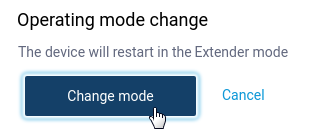

Press Change mode to confirm.
After switching the operating mode, refer to point 2 of this manual and configure the Extender's connection to the Main Router.
